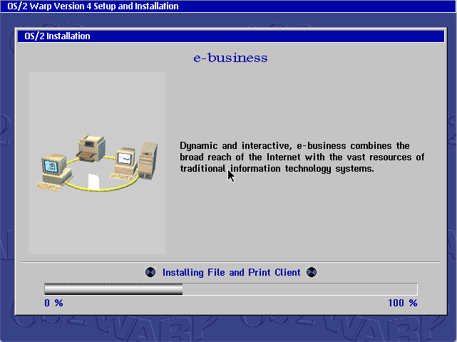

The first boot changes for AHCI, ACPI, USB-CDROM works, the installer sees AHCI disks, CD/DVD. Now I need to find the way to put these changes onto the harddrive before second boot. The changes I have made are dependent on USB option, so that need to be switched on & set up with files. Plan to move ACPI changes to SMP addon.
Die ersten Boot-Änderungen für AHCI, ACPI, USB-CDROM funktionieren, der Installer sieht AHCI-Festplatten, CD/DVD. Jetzt muss ich einen Weg finden, diese Änderungen vor dem zweiten Bootvorgang auf die Festplatte zu übertragen. Die Änderungen, die ich vorgenommen habe, sind von der USB-Option abhängig, die also eingeschaltet und mit Dateien eingerichtet werden muss. Ich plane, die ACPI-Änderungen in das SMP-Addon zu verschieben.
The USB Addon way didn't survive the 2nd boot, used a different entry point. With that it was possible make the OS2AHCI.ADD (community version), OS2APIC.PSD (ACP/WSeb) still be loaded in second boot (from C:\), It remains in the config.sys during 3rd, 4th reboot - so its final.
- after I've crosschecked how UPDCD is doing its job, only one file need to be modified from the UPDCD framework, 10 lines added so far for the AHCI and ACPI support, its possible, that only 8 needed.
- The UPDCD framework created in a way, where MCP/ACP/WSeB/Warp4/Warp3 using the same, so it supposed to work with all of them
@Sigurd it will be good for your Warp Server goal too.

There is a part after the 3rd reboot (above), when the install looks like it hung up for about 2-3 minutes. Patience, this is the time if performs the Addons install. It goes to forth reboot and its setup is done.
Details on the actual solution: - after I've crosschecked how UPDCD is doing its job, only one file need to be modified from the UPDCD framework, 10 lines added so far for the AHCI and ACPI support, its possible, that only 8 needed.
Issues:
- Fat32 and USB addons.cmd outdated, selecting any of them makes it hang on the third/forth reboot (and so on) - the config.sys for some reasons has big chunks of duplicated contents. Simplest way to replace them with a simple addon, to extract newest style usbdrv247.zip and run fat32.wpi installer
- while the SATA CD/DVD works during install, the installer can't find, or handle the SATA disk -> IDE only during install. If you change it after install is done, it works. Something around LVM, either the up2TB.FLT? Or it needs better ACPI support than OS2APIC.PSD

Der USB Addon Weg überlebte den 2. Boot nicht, er benutzte einen anderen Einstiegspunkt. Damit war es möglich, die OS2AHCI.ADD (Community-Version), OS2APIC.PSD (ACP/WSeb) noch im zweiten Boot (von C:\) zu laden, es bleibt in der config.sys während des 3. und 4.Reboots - also endgültig.
Nach dem 3. Neustart (siehe oben) gibt es eine Phase, in der sich die Installation für etwa 2-3 Minuten aufgehängt zu haben scheint. Geduld, das ist die Zeit, in der die Installation der Addons durchgeführt wird. Es folgt der vierte Neustart und die Installation ist abgeschlossen.
Details zur eigentlichen Lösung:
- Nachdem ich überprüft habe, wie UPDCD seine Arbeit verrichtet, muss nur eine Datei des UPDCD-Frameworks geändert werden, 10 Zeilen wurden bisher für die AHCI- und ACPI-Unterstützung hinzugefügt, es ist möglich, dass nur 8 benötigt werden.
- Das UPDCD-Framework wurde so erstellt, dass MCP/ACP/WSeB/Warp4/Warp3 dasselbe verwenden, also sollte es mit allen funktionieren
@Sigurd es wird auch gut für dein Warp Server Ziel sein.
Probleme:
- Fat32 und USB addons.cmd sind veraltet, die Auswahl eines dieser Programme führt dazu, dass es beim dritten/vierten Neustart hängen bleibt (und so weiter) - die config.sys hat aus irgendwelchen Gründen große Mengen an doppeltem Inhalt. Der einfachste Weg, sie durch ein einfaches Addon zu ersetzen, ist, die neueste usbdrv247.zip zu entpacken und den fat32.wpi-Installer auszuführen
- Während die SATA-CD/DVD während der Installation funktioniert, kann das Installationsprogramm die SATA-Platte nicht finden oder verarbeiten -> nur IDE während der Installation. Wenn Sie dies nach der Installation ändern, funktioniert es. Es muss etwas mit LVM zu tun haben, entweder die up2TB.FLT? Oder es braucht bessere ACPI-Unterstützung als OS2APIC.PSD
